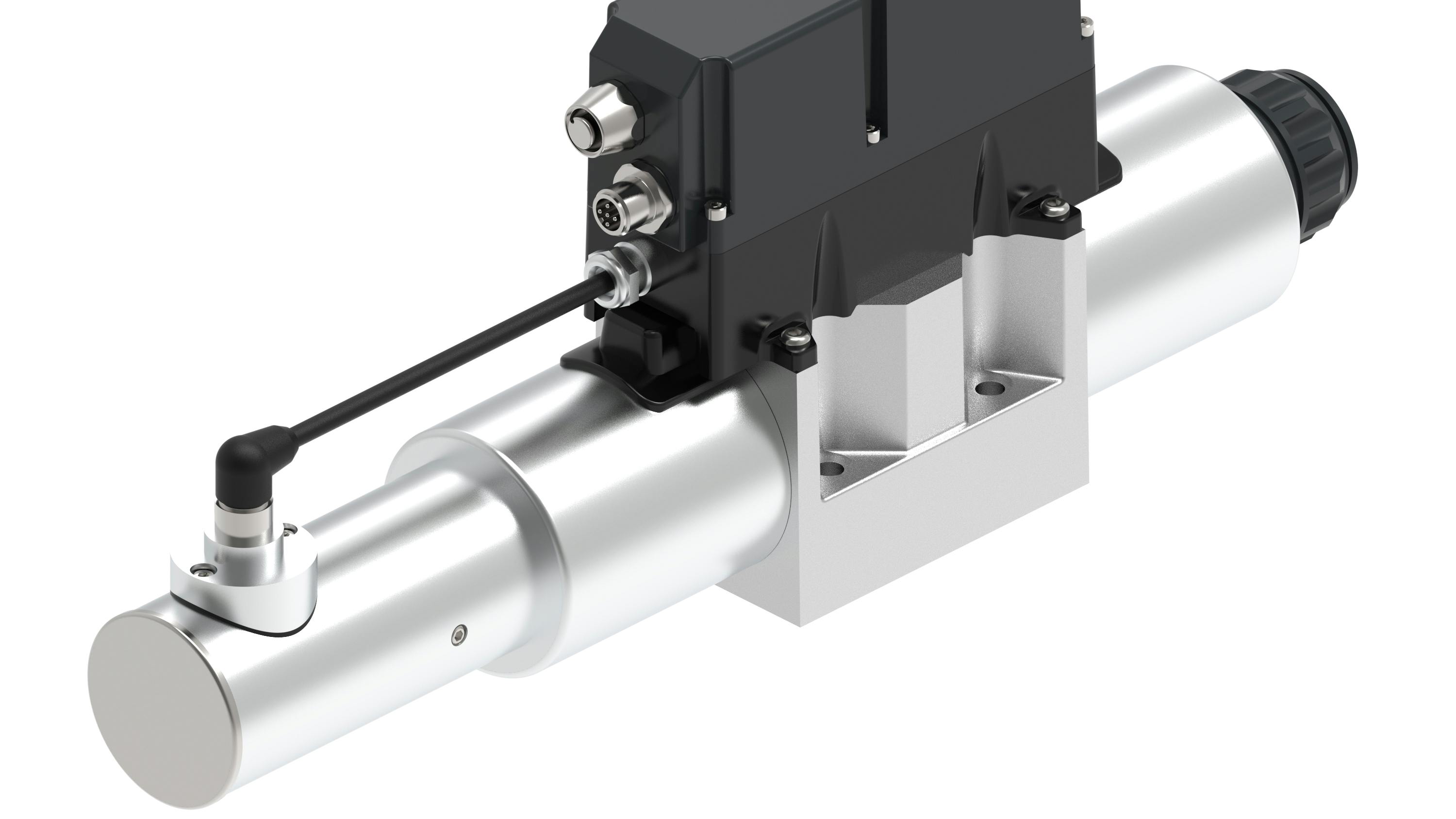

The KBFRG4-5 hydraulic valve provides higher levels of power and durability for use in a range of industrial applications.
The KBFRG4-5 from Danfoss Power Solutions is a single-stage, four-way hydraulic valve with round solenoid design for various industrial applications.
Key features of the hydraulic valve include:
  • pressure rating of 350 bar (5,076 psi)
  • maximum flow of 290 lpm (77 gpm) at 57 bar (827 psi)
  • step response of 20 ms for enhanced performance
  • multiple spool options with various flow ratings
  • IP67 ingress protection rating
  • high corrosion resistance option available
  • robust metal housing for increased vibration and shock resistance (7.8 g random, 50 g shock)
  • complies with various industry standard certifications including CE, UKCA, REACH, RoHS, and EMI/EMC.

According to Danfoss, design features such as the valve's round solenoids, external linear variable differential transformer (LVDT) as well as starndard CETOP 5 body and spools help to provide a cost-effective option for design teams.

Like most hydraulic technologies today, the valve is equipped with CAN communication to enable it to "talk" easily with other components in a system. In addition, the valve features configurable control modes, which can be programmed using Danfoss’ Pro-FX Configure software. Optional valve test kits are available to simplify on-site commissioning while the valve’s built-in health monitoring and LED indicator lights simplify diagnostics.
