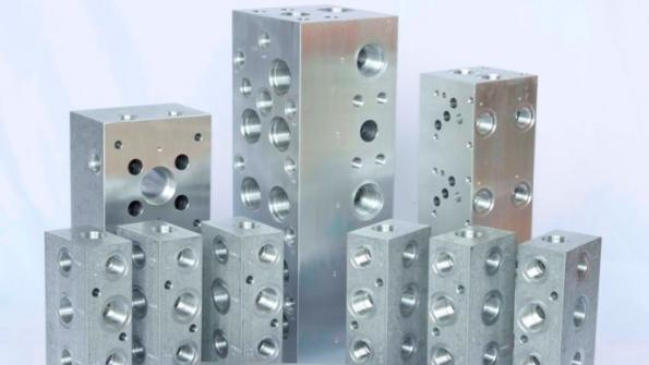

Hydraulic integrated circuits consist of a manifold and multiple cartridge and/or subplate mounted valves contained in a single assembly that can drastically reduce the number of fittings and lengths of hose and tubing otherwise required for circuits using line-mounted components.
Even though the effects of hydraulic integrated circuits (HICs) are not as dramatic as those in the world of electronics, they still can substantially reduce the size, complexity, and overall cost of hydraulic systems. Furthermore, HICs exhibit additional advantages that go beyond these benefits.
An HIC consists of a manifold containing multiple pressure-, directional-, and even proportional-control valves. In extreme cases, an HIC may even contain pumps, filters, actuators, or any combination of these to form a completely self-contained hydraulic system. Most HICs, however, consist of a manifold containing inlet and outlet ports, cartridge and subplate mounted valves (or both), and a network of internal passages that route hydraulic fluid through branch circuits of the hydraulic system.
