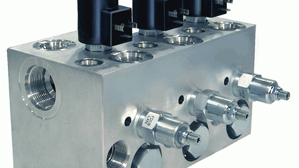

This hydraulic integrated circuit shows how different types and sizes of valves can be assembled into a common manifold for multifunctional operation. (Photo courtesy of Sun Hydraulics.)
Hydraulic systems a generation ago featured valves that were either threaded for pipe and tube mount, or used a flat gasket interface for sub-plate mounting. These systems were bulky, leaky, heavy, and downright messy. Over the last 20 years, however, many line-mounted components have given way to hydraulic integrated circuits (HICs) using cartridge valves mounted in manifolds. Cartridge valves are installed into a hole on a hydraulic manifold (typically a cube-shaped block of aluminum, steel, or cast iron), which contains internal passages to create all connections between the valves and work ports. Some cartridge valves have threaded bodies that screw into the manifold, while others slip into cavities and are held in place by a cover that is bolted down.
In terms of design, the modular capacity of cartridge valves sets them apart from other valves. For example, a single line-mounted D08 directional valve may be used to control a cylinder, while a hydraulic integrated circuit (HIC) employs four or five cartridge valves for the same job. Thus, each cartridge can be optimized for each of the functional aspects of the large single directional valve, such as asymmetrical cylinder flow, pressure intensification, decompression, soft shifting, etc. By making the cylinder’s cap end cartridges larger than the rod end cartridges (and changing other functions in a likewise manner), cartridge valves circuits can be significantly more energy efficient.

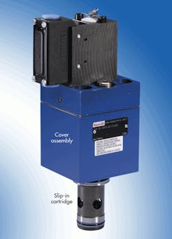

Slip-in cartridge valves are widely used for logic (open or closed) functions and offer leak-tight operation when closed. (Photo courtesy of Bosch Rexroth.)
Slip-in cartridges are usually the best choice in industrial (stationary) systems, particularly when prerequisites include high flows, high pressures, and high duty cycles. Most slip-in cartridges fall into the two-port poppet-valve category, and they are either fully open or fully closed. These are sometimes referred to as logic valves because of their either-or functionality.
All slip-in cartridge valves are pilot operated, meaning that a small amount of pressurized hydraulic fluid is used to shift the valve open or closed. The trick to designing slip-in cartridge circuits is to understand the importance of pilot pressures within the circuit, be able to read and comprehend pilot circuitry, and ensure pilot pressure is always present.
It’s also crucial to understand how orifices control the rates of opening and closing slip-in cartridge valves. Generally, at the circuit-design stage, default orifices that come with covers would be a good place to start. The ability to tune circuits for fast response and low shock by changing the size of control and damping orifices in the covers comes with experience
A slip-in cartridge poppet is normally open, normally closed, and can provide modulated control. Unlike valve spools, poppet valves provide a leak-tight seal when closed. Cartridges that shift from open to closed are directional cartridges, because they either allow flow between ports A to B, or block it. A set of four two-port cartridges can replicate the four-way P-A, P-B, A-T, and B-T functions of a directional valve.

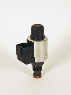

Screw-in cartridge valves are available in a wide variety of multi-port functions that emulate their line-mounted counterparts. (Photo courtesy of HYDAC Inc.)
Screw-in cartridge valves screw into threaded cavities and represent a mix between poppet- and spool-type construction. A two-port cavity can accommodate many different types of valves. For example, a C-10-2 cavity can hold a check or relief, or directional cartridge. Other cavities accommodate different valves. Screw-in cartridge valves have single-cage, or one-piece, construction.
Because their capacity starts at very low flows, screw-in cartridges are available as both direct acting and pilot operated. But unlike their slip-in counterparts, pilot-operated screw-in cartridges are self-contained units.
You do not need to match pilot and main stage functions with screw-in cartridge valves. Screw-in cartridge-valves are available in many configurations and with many options, so designers must search through pages and pages of source material to find a specific built-up configuration. After purchase, some screw-in cartridge parts may come in pieces that need to be assembled. For instance, an ac or dc solenoid may ship separately from the valve body.
Two-port screw-in valve cartridges that function like slip-in cartridges are called logic valves. Screw-in cartridges are complete valves for functions, so there’s some duplicity in calling out other valve functions. For example, one manufacturer may identify a specific screw-in cartridge as a counterbalance valve, while another manufacturer refers to it as over-center valve.
Construction of screw-in cartridges often takes the form of multi-port valves. Three-, four-, five-, and six-port valves are common for directional functions. Symbolically, they look like line-mounted spool valves. However, they’re held in a cage that’s screwed into a cavity in a manifold instead of being line mounted. Screw-in cartridges are inexpensive and used extensively in mobile equipment. They have a much smaller footprint than their slip-in cousins, lending themselves to a much more compact manifold. If the valve can handle the flow and pressure, and life expectancy is reasonable, then screw-in cartridge valves become the lowest-cost option. The historical catch, though, has been the cost, time, and risk associated with errors in manifold design, which has drastically changed.
