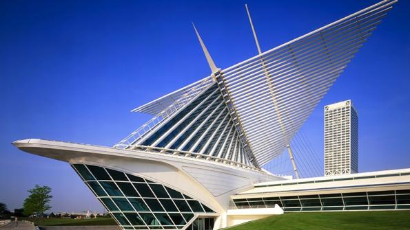

Burke Brise Soleil spreads its wings 200 ft across the Milwaukee Museum of Art.
Every city wants to have an icon — a symbol that most people immediately recognize and identify with the city. The Eiffel Tower (Paris), the Statue of Liberty (New York), the letters in the Hollywood Sign (Los angeles), and the Gateway Arch (St. Louis) are examples. Many people in Milwaukee believe that the Burke Brise Soleil, atop the new Quadracci Pavilion at the Milwaukee Art Museum can play the icon role for them. (The eye-catching Soleil also provides a practical function — aiding climate control inside the new structure.) This graceful, movable sunshade consists of a pair of wing-like structures, each made up of 36 steel ribs ranging in length from 24 to 105 ft.

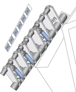

The ribs are mounted on two rotating steel shafts, in turn connected to the pavilion's spine. To open and close the sunshade, 22 hydraulic cylinders (11 on each side) stroke simultaneously to operate cranks attached to the shafts. The cranks swing a 90° arc to open the wings in 3-12 minutes.
Hadady Hydraulics Inc., Lansing, Ill., custom-built the hydraulic cylinders. These actuators — rated for 5000-psi service — have 230-mm bores and 125-mm rods. They stroke 26-12 in. Their design includes a forged alloy piston rod with a special rod-eye hinge (for installation ease). They have special sealing and guide elements for the rod and piston. Non-lubricated bearings in the rear pivot mount and the rod eye work on stainless steel pins throughout the operating cycle.

Rear-pivot mounted hydraulic cylinders with rod-eye hinges extend to operate cranks that rotate a wing-opening shaft. Click on image for larger view.

Each cylinder receives fluid through a flow-control manifold. The manifolds are fitted with orifices to control the extension and retraction speeds of the cylinders. This limits the speed at which the wings can fall if a pipe or hose bursts. The hydraulic system also is equipped with manually operated bleed-down valves. These valves serve as a back-up means of lowering the wings. And each wing has a limit switch to verify full-closed position.
