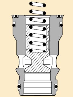

Fig. 1. Slip-in cartridge for pressure reducing consists of biasing spring, poppet, sleeve, seals, and cover plate (unshown).

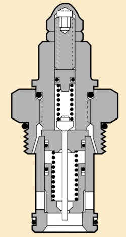

Valve cartridges can be thought of as "bodyless" - valves without an integral housing - because they consist of only the internal moving elements of the valves. After a cartridge is inserted into a cavity, such as a manifold with appropriate flow passageways, the resulting valve performs like any conventional valve. Slip-in cartridges are held in the cavity by a cover plate, Figure 1; screw-in-type cartridges mate with threads in the cavity, Figure 2. Another type of insertable cartridge has circumferential grooves. After it is inserted into the cavity, it is held in place by swaging internally with a tapered pin that expands the cartridge diameter into interference contact with the bore.

Fig. 2. Pilot-operated relief cartridge screws into manifold cavity, seals with O-ring.
