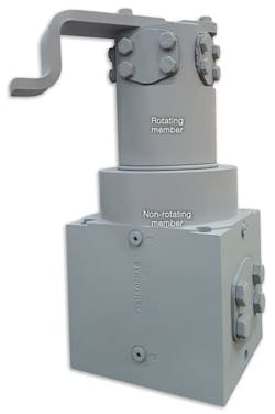

Hydraulic swivels transmit pressurized fluid from a stationary machine element to one that rotates.

Hydraulic swivels often are configured to specific machines. They come in a variety of shapes and sizes to transmit pressurized hydraulic fluid from stationary to rotating machine elements and vice versa.
