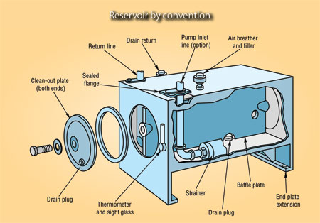

One aspect of maintaining fluid cleanliness has long been relatively ignored: reservoir design. Standardization has helped make hydraulic systems easier to design and certainly more economical, but has caused designers to almost universally specify the conventional rectangular, flat-bottom reservoir, Figure 1. As will be demonstrated, the conventional reservoir not only falls far short of an optimum design, but actually can promote fluid contamination.
Figure 1. Conventional reservoirs contain many surfaces and corners where contaminants can collect. Instead, contaminants should remain suspended in the fluid for easy removal by filters.

The usual configuration that meets these requirements is a rectangular container with flat sides, ends, top, bottom and at least eight corners, Figure 1. Inside is a baffle, screen, or both to slow down the flow of fluid from its entry into the reservoir until it reaches the pump suction line inlet.

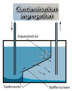

The rectangular reservoir, for the most part, meets the requirements outlined above, provided that sediments are removed regularly from the reservoir floor and that the inside of the reservoir is cleaned periodically. However, the many components inside the reservoir and its many corners make it difficult to be cleaned thoroughly. Consequently, technicians may ignore regular cleaning schedules and attempt cleanup only when absolutely necessary. Unfortunately, a condition similar to that shown in Figure 2 often results — thick layers of sediment covering the bottom of the reservoir.
Figure 2. Baffles and screens reduce fluid velocity, which helps remove air from the fluid. Unfortunately, the low velocity allows contaminants to settle, so they cannot be removed by filters.
Realizing the severe negative effect on fluid cleanliness from the long term influence of settled contamination — combined with the low priority given to cleaning out the reservoir — perhaps some of the roles of the reservoir should be altered. For example, letting contaminants settle onto the bottom of the reservoir keeps them in continuous contact with the fluid, thereby affecting its chemistry. Moreover, the surface of this sediment layer is very unstable, so a change in the return oil flow rate or direction can stir up clouds of contamination in the otherwise clean fluid. Even with careful flow regulation, stirring up this sediment layer cannot be avoided in mobile and marine applications.

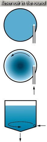

One self-cleaning reservoir is presented in Figure 3. The reservoir takes the form of a vertical cylinder with a conical bottom. A smooth transition joint exists where the vertical side wall meets the conical bottom. The suction connection for a filter or filtration circuit is located in the lowermost part of the reservoir, at the apex of the inverted cone. The return flow inlet is tangential to the cylindrical wall. When the return flow enters the reservoir, the entire mass of oil tends to slowly rotate.
Figure 3. Cylindrical reservoir with stationary oil, top, leaves contaminants equally distributed. Rotating the fluid, middle, directs contaminants to the center of rotation. As rotational velocity diminishes, contaminants settle at the bottom center of the reservoir, where they can be filtered out.
Rotating the mass of fluid directs contaminants toward the center of the reservoir. This action can simply be demonstrated by stirring a cup of tea. Fluid dynamics divert the tea leaves into the vortex of the spinning fluid. The same principles govern the rotating hydraulic fluid: solid contaminants concentrate at the center of rotation. This principle differs from that in a centrifuge, where rapid spinning introduces centrifugal force many times that of gravity, which directs particles away from the center of rotation. Unlike fluid in a centrifuge, fluid in the reservoir rotates relatively slowly, so fluid dynamics have a much greater effect on particles than centrifugal force does. Because the solids are more dense than the hydraulic oil, they eventually settle to the bottom center of the reservoir, where the filtration circuit inlet is located. From there, contaminants will be trapped by the filter instead of collecting at the bottom of a flat surface.
It is essential to rotate the mass of oil under normal operating conditions to keep particles, water, and other foreign contaminants from settling. In this manner, contamination is kept suspended in the oil until it is caught in a filter. Most of the contamination is taken out of circulation the first time it encounters a filter. Furthermore, filters are much easier to maintain than reservoirs are. Replacing a dirty filter element has become easier and more convenient than ever, and indicators make it easy to determine when an element needs to be changed. Cleaning reservoirs, on the other hand, is an unpleasant, labor-intensive procedure. Moreover, it is difficult to determine how dirty a conventional reservoir is without emptying and inspecting it. By the time you go through all the trouble, you should probably clean it anyway.

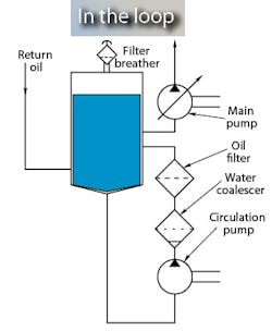

A bypass filtration circuit, sometimes called a kidney loop, works especially well with the cylindrical reservoir. A kidney loop often incorporates an oil cooler or heater as well. Fluid from the kidney loop flows back to the reservoir through a tangentially oriented tube, Figure 4. The main system pump draws fluid from the upper portion of the reservoir, where fluid is cleanest. Return oil flows tangentially into the reservoir near the bottom. No unwanted substances will be accumulated any place in the system because particles and other contaminants are continuously removed. At no time are they given an opportunity to accumulate anywhere. This results in simpler maintenance procedures, longer fluid life, and higher system reliability.

Figure 4. System with cylindrical reservoir and off-line filtration circuit.
