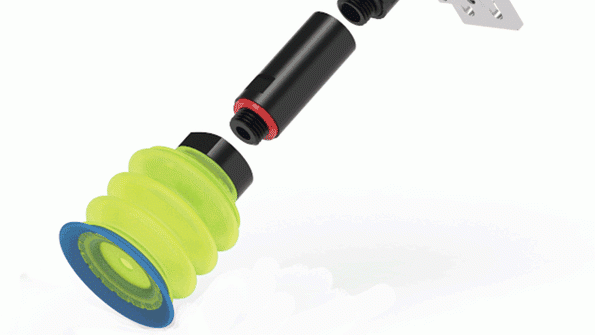

Mounting elements offer an easy way to install suction cups and accessories at the correct working position for end-of-arm tooling. The parts line — mounting brackets (MB), height adjusters (HA), suction-cup rod extensions (SE), and level compensators (LC) — is designed to fit together for different sizes and applications. Steel MBs can be adjusted horizontally and lock against an extruded profile with two included screws. HAs have an internal air channel and a long outer thread that adjusts the vertical position of the suction cup.
