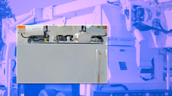

Reservoir placement in mobile equipment is often an afterthought, so designers often have to contend with irregular shapes in less-than-ideal locations.
The primary function of hydraulic reservoirs is to temporarily store hydraulic fluid. If properly designed, they can also function as fluid-conditioning devices. That is, they not only provide fluid to meet varying demands as actuators extend and retract, but can also prepare the fluid for its next working cycle.
