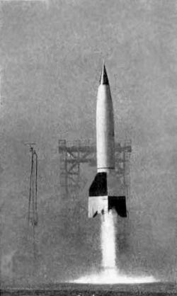

The German V -2 type missile in an early stage of launching flight at White Sands, New Mexico. (All photographs courtesy of the United States Air Force)

The cessation of hostilities and subsequent removal of security barrier revealed the comparatively startling advances made by German scientists and designers in the missile field. A multitude of both subsonic and supersonic craft of varied types was either under development or developed for operational use; some of these missiles had reached a high degree of performance. Notable among the latter were the popularized V-1 and V-2 type. In some respects, the V-2 typifies a successful craft and is a standard research vehicle currently used both in this country and abroad.
The wartime V -2 was a ground-launched, self-propelled bomb, 45 feet high and carried a 2,000-lb warhead. A typical fuel load consisted of 7,000 lb of alcohol and 11,000 lb of liquid oxygen, bringing the total weight of the fueled missile to 28,000 lb. Complete burning time was limited to approximately 60 seconds. After fuel cut-off, the missile became a free body and assumed the usual trajectory of a projectile. The maximum velocity, which occurred at the time of thrust cut-off, was approximately 3,800 miles per hour.
It is quite apparent that the fuel consumption and power required to drive pumping machinery are beyond normal expectations. Moreover, the fuel was fed into the burners by two pumps, both steam turbine driven. The steam was generated on demand by the decomposition of approximately 300 lb of highly concentrated hydrogen peroxide. Products of this decomposition were superheated steam at 700° F and 700 psi and some free oxygen. The total weight of pumps and turbine was·220 lb.
The control surfaces of the missile were operated by means of individual hydraulic servos. System pressure was developed by electrically-driven gear pumps totally submerged in the oil sump to prevent formation of air pockets and to reduce line length to an absolute minimum. The latter requirement was imposed by the installation of the pump and servo units directly into the tail fins. It should be remembered that space limitations in most missiles are almost always critical, regardless of the equipment concerned.
