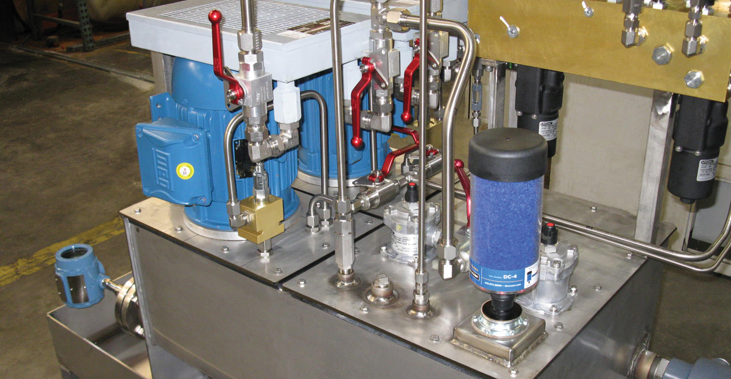

Desiccant Breather as a Troubleshooting Aid
Protecting the centralized hydraulic system is simple and cost-effective through desiccant breathers and oil filters. Desiccant breathers filter particles and adsorb moisture from incoming air to prevent both from coming entering the reservoir. But desiccant breathers don’t just remove moisture only from air entering the reservoir. If moisture is present in the reservoir’s headspace (the air above the hydraulic fluid), the desiccant breather will adsorb the moisture and keep the reservoir dry.
The desiccant changes color as it adsorbs more moisture. This feature actually serves as a troubleshooting tool, because if the desiccant breather repeatedly becomes saturated, either the ambient air is extremely humid, or water is getting into the hydraulic system somewhere. This means a desiccant breather can be used as a troubleshooting tool.
For example, consider two identical hydraulic systems—one in Florida and one in Arizona, representing humid and arid environments, respectively. If the breather’s desiccant changes color from bottom to top, the more-humid environment exists outside the reservoir (Florida). This is because air moisture laden air entering the desiccant breather (from the bottom) becomes drier as it travels upward through the desiccant bed.
Likewise, when the desiccant changes color from top to bottom, the more-humid environment exists inside the reservoir (Arizona). Desiccant at the top of the breather (where air from the reservoir enters) adsorbs more moisture than desiccant at the bottom (closest to the dry atmosphere). This condition indicates that the more-humid air is inside the reservoir—evidence of water in the hydraulic fluid. If the source of the water is not identified and corrected, problems with water contamination will occur.
