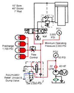

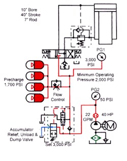

This reduced flow and horsepower are possible when using accumulators and the circuit shown in Figure 1-10. The extra expense of the accumulators offsets the reduced price for the power unit, but operating cost is less for the life of the machine. The directional valve and piping from the accumulators to the cylinder still has to handle the 125 gpm flow.
Fig-1-10
Using a gas charged accumulator in a pump supplementing circuit will increase maximum system pressure. The extend portion of the cycle needs at least 2000 psi working pressure, which requires filling the accumulators with fluid above 2000 psi so they can discharge oil and not drop below minimum pressure. The maximum system pressure should be as high as can be tolerated. The higher the maximum allowable system pressure, the smaller the accumulators. The drawback of high pressure is that the circuit is at this pressure when the cycle starts. If this higher pressure can cause damage or other problems, it should be lowered to a safe level.
Accumulator circuits normally have flow controls because there is a volume of oil at elevated pressure that can discharge almost instantaneously. Placing a flow control at the accumulator outlet allows free flow from pump to accumulator and adjustable flow to system.
The circuit in Figure 1-10 has a minimum pressure of 2000 psi and a maximum pressure of 3000 psi. This pressure is the limit of most hydraulic components. A 22-gpm pump driven by a 40-hp motor now meets the force and cycle time specified. All pump flow continuously goes to the circuit instead of being unloaded most of the time as in conventional circuits.
As the cylinder cycles, the accumulators supply fluid at a rate set by the flow control. Pump flow adds to accumulator flow to set the required cycle time. Cylinder cycling could be made faster than specified by increasing outlet flow from the accumulator.
The fixed-volume pump in Figure 1-10 unloads through a special accumulator relief/unload/dump valve, which sends all pump flow to the accumulators and cylinder until the system reaches set pressure. After reaching set pressure, the valve opens and unloads the pump to tank at approximately 50 psi. The pump will continue to unload until the system pressure drops about 15%. This pressure drop might be from leakage or at the start of a new cycle. Any time pressure drops, the pump will load and stay loaded until pressure tries to go above 3000 psi. With this valve, stored oil in the accumulators automatically discharges to tank when the pump stops, which makes the circuit safe to work on shortly after locking and tagging off the pump.
