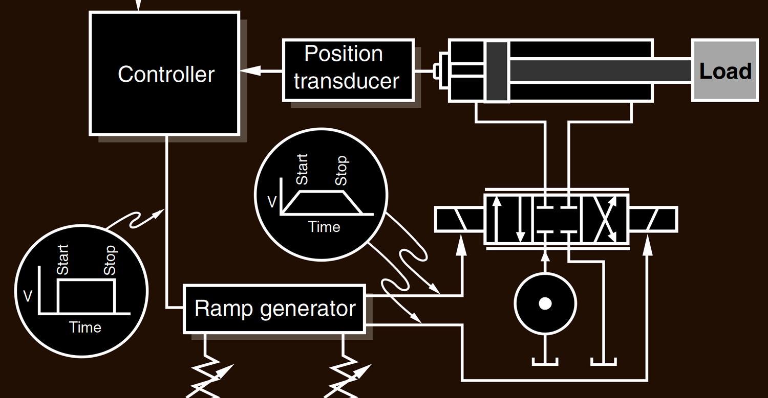

Figure 4 shows the second step toward motion control, which uses a proportional valve instead of the discrete directional valve. As with Fig. 2, the schematic diagram is not complete; rather, it is intended only to point out the obvious advantages of using proportional rather than on-off control. Note that the cylinder is outfitted with a position sensor that measures the position of the piston relative to the cylinder tube. The sensor works full-time—it is always sending an analog output signal to the controller.
The controller is depicted as a digital device into which a deceleration point can be entered, probably by means of a conventional keyboard. Being a digital device, it can give its attention to only one item or task at any given instant. That is, when it “looks at” the deceleration set point, it cannot be looking at the position sensor output. There must necessarily be a time lag between these two events. Additionally, the PLC probably has many other tasks that will divide its attention, such as monitoring and controlling temperature, reservoir level, and more. The resulting delay is the scan time of the controller, and it dictates how well the system performs.
Thus, we see that each of the tasks is actually serviced at regular intervals. The total time lag between the instant when one task—say, monitoring the position sensor output and the instant when it does so again—is the total scan time. Furthermore, the instant when an event occurs will not be synchronous with the instant that the controller actually looks and sees the event. This results in random variation in the stopping point.
Continuing around the loop of Fig. 4, note that the output of the controller consists of the start-stop signal, which is generated based on a comparison between the deceleration setpoint and the actual position from the position sensor. Also note that the start-stop signal from the controller is not connected directly to the valve solenoids. Rather, it is connected through the ramp generator.
The ramp generator is a common option on many proportional valve amplifiers. It ramps up the output until it equals the command voltage if the command input goes to a high level. Without the ramp, the amplifier output would jump up almost as quickly as the command signal from the controller. But with the ramp generator, even if the command is a step (as shown in the figure), the output is a signal to the valve coil that changes slowly. This prevents the spool from suddenly jumping to a proportional position. Instead, the spool slowly opens or closes, giving a considerable degree of acceleration control.
The ramp circuit is outfitted with trim pots to allow the user to adjust the rate at which the output changes, thus controlling the rate at which the valve spool shifts. This constitutes a vital improvement over the on-off control offered in the discrete directional system because the shocks are significantly reduced. Furthermore, the adjustability of the ramps gives the user immediate feedback as to the effectiveness of the adjustments.
A Case in Point
In a typical operational scenario, imagine that the start command has been given, the valve spool has ramped to a proportional position, and the cylinder is extending at some desired speed. Now suppose that the position sensor puts out a signal of, say, 1 V for every inch of travel away from the cap end of the cylinder, and that the deceleration setpoint is set to 6 V. We then expect that the deceleration will be initiated when the cylinder extends to 6 in. This is the progression of events:
In the early parts of the cycle, the cylinder will be at a position less than the 6 in.—6 V from the position sensor. Next, the controller obtains the position signal and compares it to the deceleration setpoint. Because the setpoint is greater than the feedback signal, the controller issue a high output, commanding the valve to be open.
The piston continues extending and eventually will reach a position of 6.0000 in. Assuming perfect calibration, the position sensor will be generating 6.0000 V. Unfortunately, the controller will not be looking at the position sensor at that instant—the likelihood is very nearly zero. Instead, it will look only after the cylinder has over-traveled slightly. The amount of overtravel depends on the PLC scan time and the piston velocity at the instant the scan takes place.
At any rate, the position feedback sensor output eventually will exceed the deceleration setpoint value, and the controller will get around to scanning the sensor. The comparison will be made and judged to have resulted in over-travel, and the controller will issue a stop command.
The stop command merely means that the command will go to zero within a few milliseconds, perhaps even within a few microseconds of detection. But because of the ramp generators, the valve will not center quickly. Instead, it brings the cylinder to smooth and gentle stop. This will have been an effective means for controlling shock and vibration. And to some extent, it will have overcome the challenges from having a low hydromechanical resonant frequency.

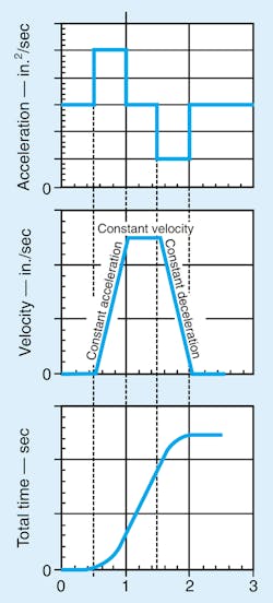

The motion-control profile is crucial to the motion control system, and represents the most significant contribution of the digital computer to the motion-control process. The profile is the means by which acceleration, velocity, and position are controlled simultaneously. Profiles are very easily generated by a digital computer (motion controller card or circuit board), and are formulated at design time to determine the peak speeds that must be attained by the actuator based on a stated productivity rate.
In determining these peak speeds, we must first collect data on the productivity needs of the application. For example, suppose the application requires stamping out 30 packets of paper plates per minute. Immediately, we know that the cycle rate is 12 cycles per second. Further, if we are given that cylinder stroke must be, say, 4 in., and that the cylinder must remain extended for 0.5 sec., then we know that the actuator must fully extend and retract within 1.5 sec. We can add some reasonable acceleration times, plus take into account that the cylinder does not naturally want to retract as fast as it extends. (Yes, this statement is correct for the valve-controlled cylinder.) To compensate for this, we can rob a few milliseconds from the extension time and give it to the retraction time. This allows us to reach conclusions about the maximum speed needed in order to achieve the required productivity rate.
This example leads us to the conclusion that the peak extend speed will have to be about 10 in./sec. Once we are given the maximum thrust force, we can design for a given supply pressure, which makes it possible to completely size the critical components in the system. Our example introduces the idea of a motion profile, which is a means of defining the speed, acceleration, and position of the cylinder and load at any instant within each cycle and throughout each and every cycle for the entire life of the machine.
The relationship between acceleration, velocity, and position —which are drawn against a common time axis—is represented in Fig. 5. Newton revealed through the calculus that:
  • velocity is the integral of acceleration
  • position is the integral of velocity
  • velocity is the derivative of position, and
  • acceleration is the derivative of velocity.
Even if you never studied calculus (see "Calculus Simplified" below), these are mathematical facts of our physical world. What they mean to the motion control system designer is that specifying any one of these three parameters for all time automatically specifies the other two as well. This is because of their undeniable relationship to each other—they are all integrals or derivatives of each other.
This relationship makes it possible to achieve the simultaneous control of acceleration, velocity, and position, even though the final system closes the loop with position feedback only. It works like this: The position profile, the plot at the bottom of Fig. 5, is the actual command to the motion-control servomechanism. The slope of the position profile represents the velocity of the output at each and every instant in time. The slope of the velocity profile is the acceleration profile, which is actually carried in the curvature of the position profile. So the designer controls acceleration by controlling the curvature of the position command profile.
The final result is this: For merely having fed the position command profile to the motion control servo axis, all three dynamic variables are implicit in that profile. Furthermore, designing a servo axis that faithfully follows the command profile, controls all three parameters. This is the sum and substance on modern motion control philosophy.
At design time, the design methodology recommends that the entire motion control profile, acceleration, velocity, and position, be synthesized based on productivity and other motion needs. In contrast, at commissioning time the programmer of a dedicated motion controller card may only specify that the motion must go from, say, position x to position y with maximum speed of v and maximum acceleration of a. The digital motion controller interprets these as instructions, then generates the actual profile commands on the fly. Consequently, the programmer may never see the entire profile itself.
