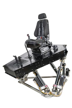

We focused on perfecting the synchronization between the electrically actuated motion base and HMD. Milliseconds before the simulator generates an image for the pilot to see, the software we developed compensates for any move of the motion base and changes the position of the “aircraft” fed to the pilot’s HMD. Motion compensation software employing advanced algorithms and motion sensors marries real and virtual elements. And control loading technology seamlessly integrates the cyclic, collective, and pedals with the motion base and HMD.
As for the specifications, the FTD we developed weighs 1,000 kg, including a 300 kg payload with the pilot wearing an HMD and seated atop the motion base. The six-degrees-of-freedom electric motion base fastens on top of a platform measuring approximately 2.2 by 2.7 m, which is slightly larger than the FTD’s motion envelope. The system uses three phase power.
Communications for the system are handled with a controller talking to the system devices as well as a host. The FTD uses a real-time operating system which runs on a 64-bit computer and acts as a master EtherCAT node. Communications with the motion drives and control loading system, or CLS, also happen via EtherCAT.
The FTD can acquire and generate signals using IO devices that transfer data with EtherCAT, too. The FTD transmits host data (e.g., vehicle dynamics and generic motion base control) through the network via the user datagram protocol, UDP.
