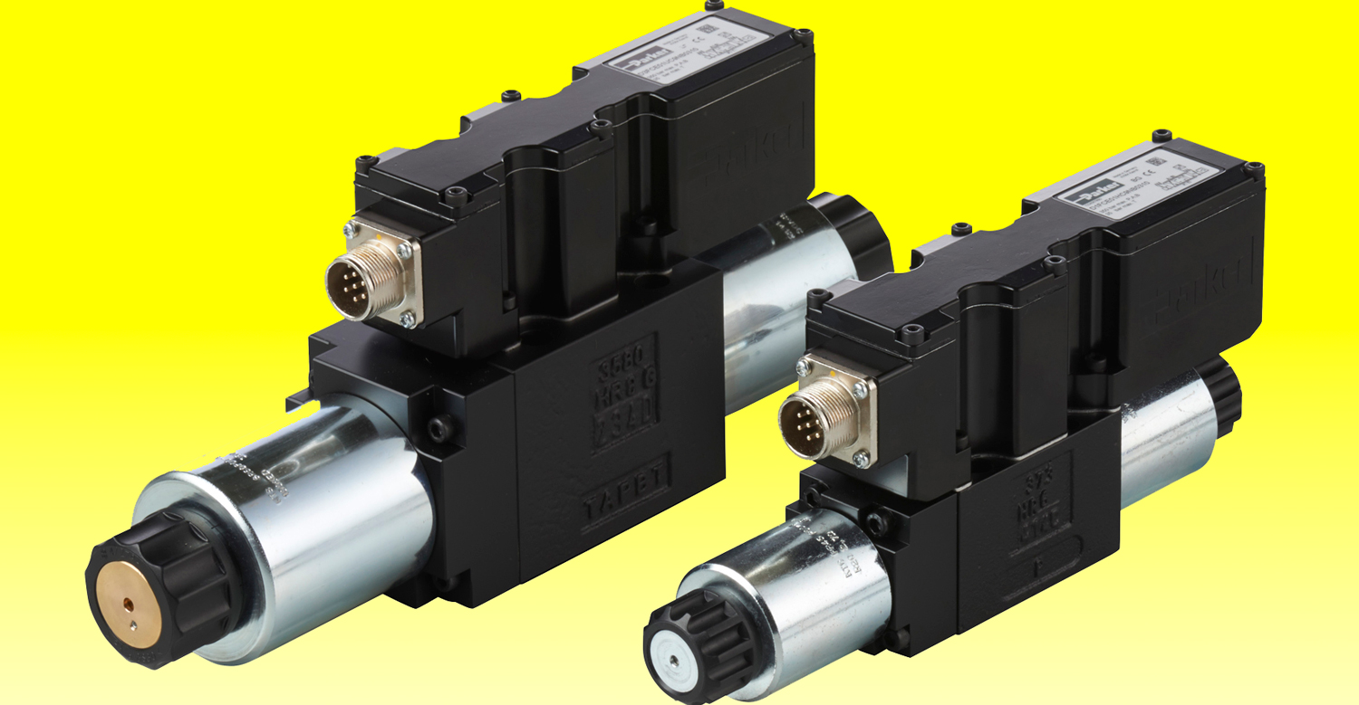

There are various types of electrohydraulic valves which can be applied in many different ways, with common variations including proportional and on/off versions.
The basics of electrohydraulic valves are simple: They are electrically operated valves that control how hydraulic fluid is sent to actuators. However, to use them efficiently and effectively, designers must consider several factors.

Onboard vs. Offboard Electronics
Determining whether a valve with onboard or offboard electronics is the best choice requires an in-depth evaluation of the application. Generally, onboard electronics put control at the valve, thus simplifying the wiring at the controller. Offboard electronics are often used in areas with high vibration levels and temperatures that can degrade the electronics’ performance.
Driving an offboard electronics valve requires an electronic module, such as a series PWD00A-400, which can be configured to customer-specified parameters such as desired solenoid drive current or ramp rates. Onboard electronics valves can be commanded directly with a standard command including 4-20 mA or ±10V DC and allow for the same level of customization.
