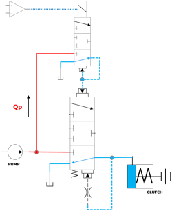

Motivating this study of EPPC valves was the author’s experience analyzing AT clutch control systems for heavy mobile equipment, where performance variation and unpredictable instability events drive a tedious, ad hoc process when qualifying new transmissions, cause wear and warranty issues, and occasionally result in clutch failures.
The hydraulic clutches in question were energized by a two-stage EPPC valve with the common architecture illustrated in Figure 1 below. Also illustrated in Figure 1 for comparative purposes is a two-stage pressure control valve (PCV) with spring energized pilot. The statement-of-work called for a linear system analysis to better understand, and resolve, unpredictable stability events.
When the linearized study failed to provide a clear resolution, the author conducted his own non-linear analysis. The resulting simulations demonstrated that two-stage EPPC valves sharing this architecture are fundamentally unstable, but conditionally operable due to a discontinuous non-linearity that disrupts energy exchange between the coupled pilot and spool stages. Specifically, this discontinuity is the limit of pilot travel as the poppet (metering oil flow from pilot chamber to drain) slams onto its seat.
The result is a non-linear dynamic phenomenon referred to as a limit cycle — in physical terms the armature/poppet chain will ‘buzz’ continuously — slamming onto the poppet seat, reversing direction to open momentarily before once again slamming shut. These pilot stage limit cycles vary in frequency and magnitude, depending on operating conditions and system inputs, and influence the stability of the output spool-stage. Were this behavior to be observed by laboratory position measurement of the armature, it may very well be mistaken for dither generated by the pulse width modulated (PWM) coil driver.
This conclusion was supported by simulations that ‘virtually’ substituted the conventional 2-way pilot as illustrated in Figure 1 with a “bi-directional pilot” (drawn as a conventional 3-way spool) as illustrated in Figure 2.
This virtual test maintained pilot mass and flow area gradient and essentially allowed the pilot poppet to move ‘past’ the seat to reverse pilot flow to charge the pilot volume. By removing this discontinuity, energy exchange was not disrupted, but reversed, and the pressure output became unstable over the entire operating envelope. In fact, there was not any practical combination of parameters discovered that would globally stabilize the valve.

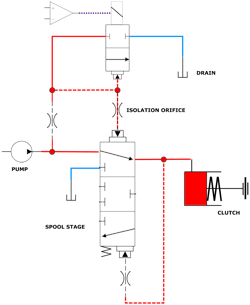

One convenient method to stabilize these two-stage EPPC valves, illustrated in Figure 4, deploys an isolation orifice between the pilot stage and spool. This configuration is commonly found in industrial valves, and in niche cartridge valves intended for the mobile market. If the application calls for slowly varying input signals, the response time is satisfactory. However, for applications that require rapid adaptation, the isolating orifice typically induces latency that is unsatisfactory.
