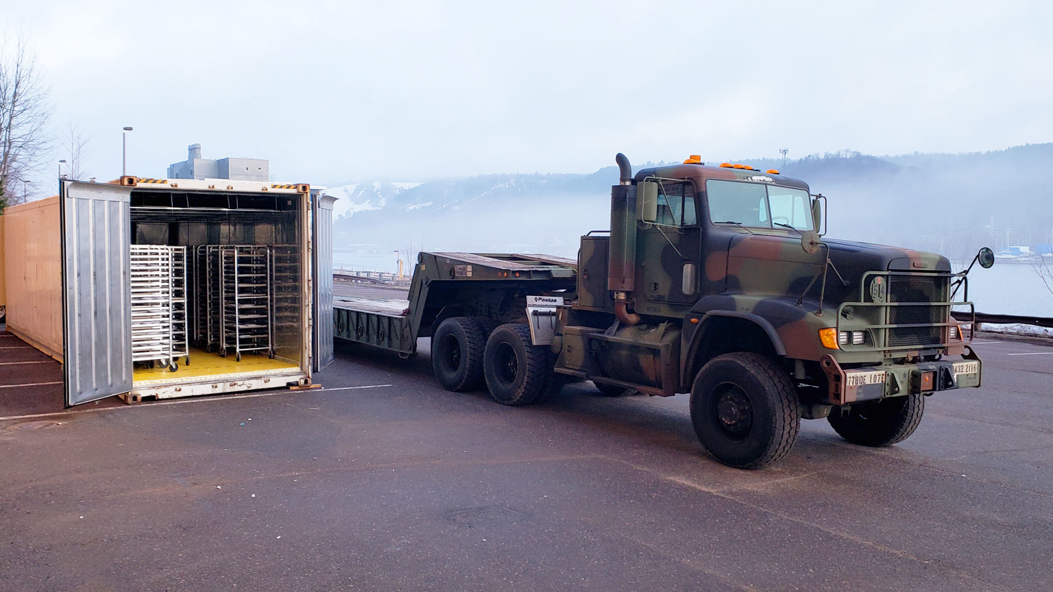

In this case, it took an engineering team at Michigan Technological University just two days to build a mobile thermal utility (MTU) sanitizer using off-the-shelf parts—a shipping container, 25 racks and a heating unit—and assemble experts to put a prototype together.
The engineers’ stated plan: “Disinfect protective equipment (PPE) at temperatures hot enough to break up coronaviruses and do so in a big, moveable oven that can be quickly made with local, off-the-shelf parts that are easy to get and put together.”
A refrigeration unit was swapped out of a thick-walled shipping container and replaced with a heating unit run on an electric generator. The unit, lined with stainless steel racks and trays for holding PPE, can heat up to 140-170°F, clean 5,000 to 10,000 PPE units every two hours and run continuously.
The parts are all available in commercial bakeries, restaurants, HVAC shops, shipping yards and universities, noted the engineers. The prototype was tested in a campus parking lot alongside local air conditioning contractor Aire Care before heading off for further validation testing.
