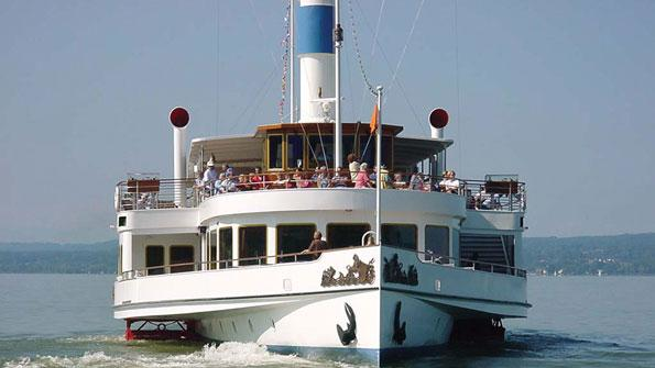

On Lake Ammersee, near Munich, Germany, two paddle steamers take passengers through the Alpine foothills. A popular vacation activity, travelers experience the natural beauty of Bavaria while using modern Swedish-German technology.  The two steamers, RMS Diessen built in 1908, and RMS Herrsching built 70 years later, use intriguing drive technology. Diesel engines are used to supply a hydraulic system that drives the paddles directly from two heavy-duty engines from Bosch Rexroth.
Paddle boats in Bavaria take vacationers on cruises using low-speed, high-torque motors for propulsion.
On Lake Ammersee, near Munich, Germany, two paddle steamers take passengers through the Alpine foothills. A popular vacation activity, travelers experience the natural beauty of Bavaria while using modern Swedish-German technology. The two steamers, RMS Diessen built in 1908, and RMS Herrsching built 70 years later, use intriguing drive technology. Diesel engines are used to supply a hydraulic system that drives the paddles directly from two heavy-duty engines from Bosch Rexroth. This technology allows the hydraulic motors to provide full torque across the entire output range, so the boats need no mechanical transmission units, and they react quickly to control orders.
