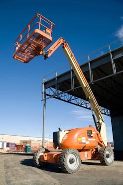

Mobile equipment propelled by a hydrostatic drive, such as this aerial lift, often requires two drive modes: parallel flow for differential operation and positive traction to prevent wheel slip under adverse conditions. A gear-type flow divider incorporating a two-way solenoid valve lets operators select between differential or positive operation.
