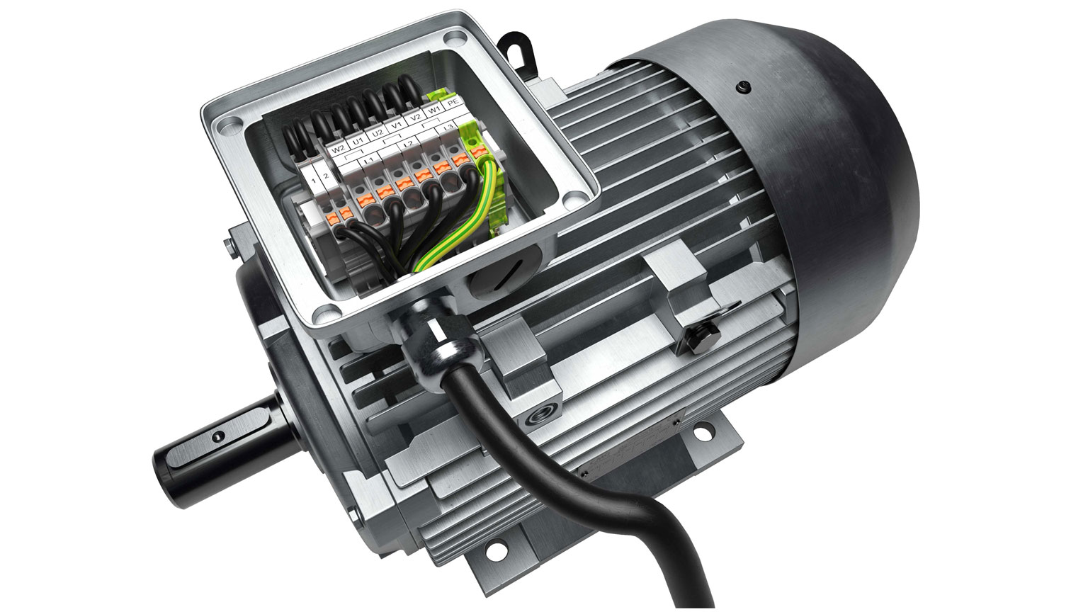

The TOPJOB S Mini terminal block series includes a version for 12 AWG. Like the rest of the Mini family, this version features all of the advantages of the TOPJOB S terminal block line but comes in at a size 60% smaller than the company's standard terminal blocks. The 12 AWG variant is able to operate at up to 600 V and 20 A and has UL 1059 approval, as well as AEx, ATEX and IECEx for hazardous locations.
Featuring the Push-in CAGE CLAMP connection technology used throughout the TOPJOB S series, this Mini terminal block is available with open tool slot or the easy-to-identify orange push buttons that can be easily actuated with any standard tool. It can also be mounted in various ways: miniature rail, snap-in mounting foot for chassis mount or direct mount with fixing flange.
