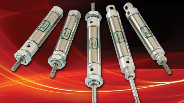

Stainless steel air cylinders now come in 9⁄16-in. bore. With strokes to 4 in. Available in stud or universal mount, double, single, or reverse acting, and with rotating or non-rotating rod. As with other sizes in line, they have polished bore, rolled construction with machined aluminum heads, sintered bronze bushing, ground, polished and roller burnished 303 stainless rod, and Buna-N U-cup piston and rod seals. Clippard Instrument Laboratory,
