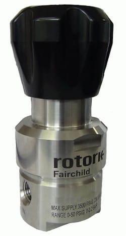

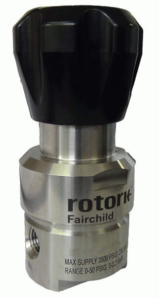

High-pressure regulators from Rotork Fairchild feature a diaphragm for high accuracy and pressure regulation, especially with fluctuating supply pressures.
High-pressure regulators feature a diaphragm for high accuracy and pressure regulation, especially with fluctuating supply pressures. Improved valve seat sealing technology eliminates media leakage. Constructed of 316 stainless steel, they are available in two models: HPD diaphragm style unit is capable of 6000 psi (413 bar) supply pressures and HPP piston style unit is suited for supply pressures to 10,000 psi (689 bar). Both are available with ¼-in. ports in 2 or 4 port configurations and in multiple output pressure ranges.
