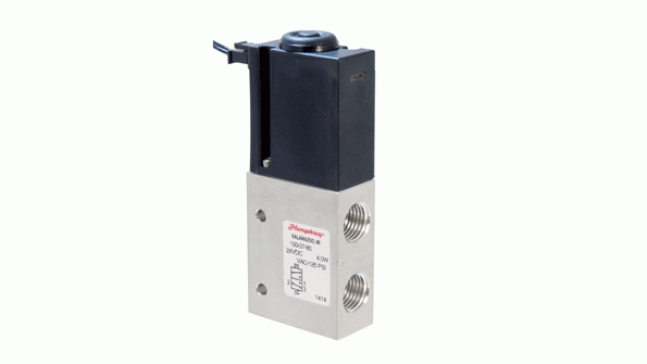

The 193 Series of balanced solenoid valves are the new 19-mm version of the company’s 15-mm 153 Model.
The 193 Series of balanced solenoid valves are the new 19-mm version of the company’s 15-mm 153 Model. Each three-port valve offers significantly more flow than the 153 (153 offers 0.25 Cv; 193 offers 0.65 Cv), while fitting into tight spaces. The 193’s balanced-poppet design neutralizes internal forces generated by the pressurized media. Features include two or three-way service, NO or NC function; diverter function; selector function; works with either clean or air with impurities; and applicable from vacuum to 125 psi.Humphrey Products Co., (269) 381-5500
