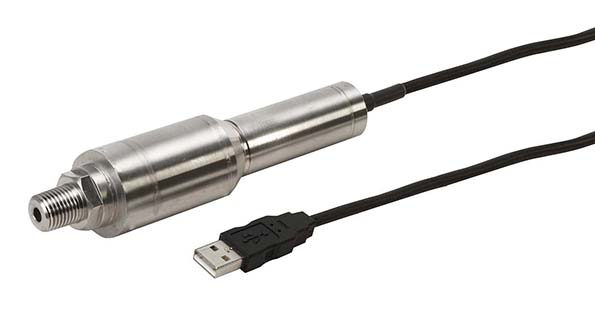

PX51-USBH pressure sensor features a high precision 1kHz 24bit USB core combined with heavy-duty bonded film pressure sensor. USB output allows pressure ranges up to 30,000 psi. It
PX51-USBH pressure sensor features a high precision 1kHz 24bit USB core combined with heavy-duty bonded film pressure sensor. USB output allows pressure ranges up to 30,000 psi. It has a stainless steel body with choice of Imperial or Metric pressure ports. The transducer is temperature compensated from 60 to 160 °F and operational between -50 and 185°F. Available in pressure ranges 750 to 30,000 psi. Accuracy is ±0.025% FS and span, and zero thermal effects are 0.003 and 0.005% FSO/°F.
