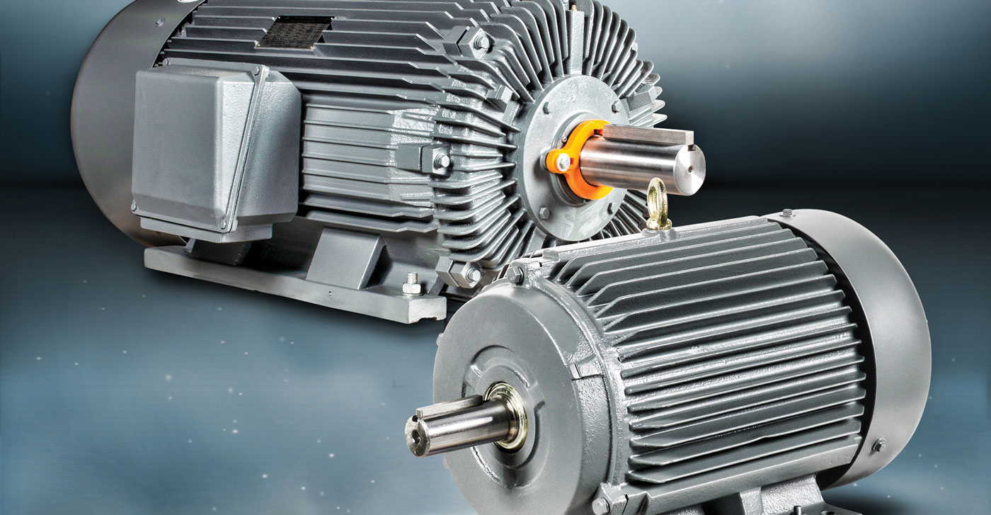

IronHorse MTCP2 industrial duty motors meet the premium efficiency requirements of the Energy Independence and Security Act of 2007.
IronHorse MTCP2 industrial duty motors meet the premium efficiency requirements of the Energy Independence and Security Act of 2007. They are offered in T-frame (1 to 300 hp) and TC-frame/C-face (1 to 30 hp) models. C-face kits are available for motors greater than 30 hp. These motors are available in 1,200, 1,800, and 3,600 rpm and have TEFC (Totally Enclosed Fan Cooled) enclosures with cast-iron frame and ribbed design for maximum cooling. The motors feature full length, cast-iron mounting feet, steel fan cover, and cast iron junction box with rubber gasket and rubber dust cover. Motors have ball roller bearings, with maintenance-free bearings for 10 hp and below. The motors are electrically reversible with Class F winding insulation.
