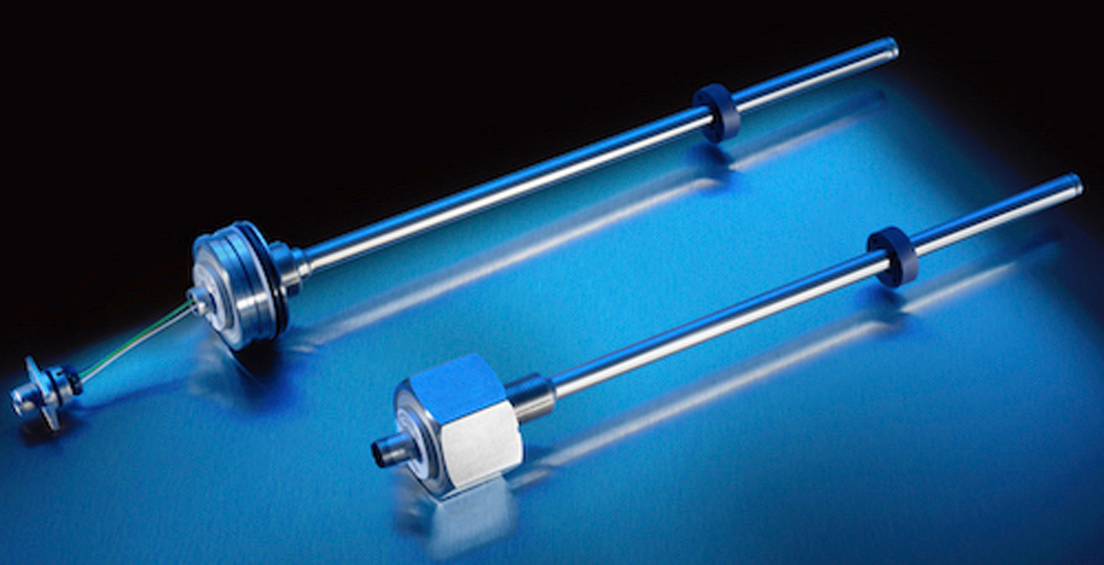

TM1 Series magnetostrictive linear hydraulic and pneumatic position sensors offer a compact fit for the user’s application.
TM1 Series magnetostrictive linear hydraulic and pneumatic position sensors offer a compact fit for the user’s application. A magnetic ring-shaped marker is affixed to the application’s moving cylinder and moves up and down the TM1 rod without contact. TM1 stroke lengths are from 50 to 2,000 mm in 25 mm increments. They accommodate pressure to 5,076 psi (350 bar) with peaks to 6,526 psi (450 bar). Both plug-in and screw-type flange models are available. Other key specifications: absolute linearity of ≤ 0.04% FS (min. 0.3 mm) and repeatability of ≤ ±0.1 mm. Output options include 4 to 20 mA current as well as voltage output of 0.25 to 4.75 V, 0.5 to 4.5 V, or 0.1 to 10 V. Ingress protection is to IP 69K; shock and vibration are 100 G and 20 G, respectively. Operating temperature range is –40 to +105°C.
