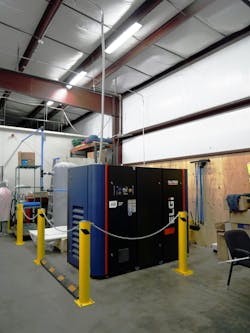

Oil-free air compressors use other methods for lubrication of components

Oil-free air compressors use other methods for lubrication besides oil such as water, special coatings or are constructed to prevent mechanical contact. The lack of oil moving through the system eliminates the possibility of oil mist in the outlet air as well as potential oil leaks or spills.
However, Horneman said there is the drawback of the air compressor running hotter and less efficiently because there is no oil to cool the air or seal the housing. The air dryer used with the compressor – to take moisture out of the system – often needs to be larger for oil-free options to compensate for the extra heat generated. The life expectancy for an oil-free air compressor is lower as well because of the lack of oil for lubrication.
