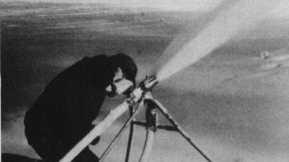

At Vermont’s Mount Snow Ski Area, water drawn from Lake Snow at the foot of the mountain is pumped to the summit. At a pressure of 240 psi, this water is delivered to several snow-making hydrants at intervals along a 33-mile piping system. The pressurized water is released to atmosphere through the hydrants' guns and atomized by compressed air at 70 to 80 psi. When ambient temperatures are below freezing, the water crystalizes into snow. The snow-making guns, which may operate around the clock, can generate up to 1 ft of snow per hour per acre.
