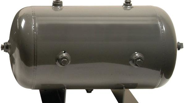

This 80-gal air receiver is ready to have a compressor, drive, relief valve, and other components installed to make a complete power source of compressed air.
