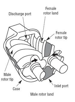

As male and female rotors turn inside case (top), dark gray atmospheric air fills pilot root from inlet port to case end. With further rotation, female tip passes inlet, sealing the rotor while simultaneously engaging male-rotor tip to begin compression. Just as intermeshing male tip has rolled far enough down female root to produce specified pressure, far end of female root uncovers discharge port.
The rotary-screw compressor is another positive-displacement machine. In an analogy with the reciprocating compressor, the male rotor is like a piston, pushing air along the female rotor, which is like the cylinder. Sealing strips are analogous to piston rings, and air is compressed against the stationary end plate, which is like the bottom of the cylinder. This design has been around for more than 50 years. However, until the mid 1970s, it was considered suitable only for engine-driven portable compressorss and small-horsepower electric-motor units because of low efficiency (the ratio of compressed-air delivery to power cost).
In the 1970s, development began on two-stage rotary screw compressors for pressures up to 250 psi. Rotor-profile development during the 1970s, 1980s, and early 1990s has led the oil-cooled rotary-screw design to become the significant choice in electric-motor-driven, lubricated, industrial air compressors, particularly in sizes from 20 to 300 hp.
Then, a significant breakthrough in air-end design occurred. The introduction of the unsymmetrical profile resulted in an efficiency improvement of approximately 15%. This improvement was significant enough to make the oil-cooled rotary-screw compressor competitive in the larger-horsepower sizes for continuous duty. It has almost the same efficiency as the single-stage double-acting units and smaller centrifugal compressors.
Two-stage rotary-screw compressors can approach and sometimes equal the full-load performance of two-stage reciprocating units in 100-psig class service. Today, two-stage oil-cooled rotary-screw compressors are frequently used in the 150- to 400-psia pressure range. They also are used for 100-psi service with significant power savings. Two stages offer advantages associated with lower compression ratio per stage. Reduced pressure differential across the rotors minimizes blow-by and significantly reduces thrust-bearing loads. (Obviously two-stage units require two air ends, which increase the initial cost.)

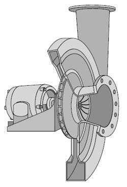

Dynamic, or centrifugal compressors are dissimilar to the positive-displacement machines already discussed because they raise the pressure of air by converting the energy of its velocity into pressure. First, rapidly rotating impellers (similar to fans) accelerate the air. Then, the fast flowing air passes through a diffuser section that converts its velocity head into pressure by directing it into a volute.
Because the centrifugal is a mass flow compressor, it has a limited stable operating range. This has a large effect on economic operation or bhp/100 cfm delivered at part load. Minimum turn-down capacities for centrifugals may vary from 20 to 30% of full load, depending on impeller design, number of stages, etc.
Cutaway view of single-stage, single-inlet centrifugal compressor with closed-type impeller. Electric drive motor can be seen at left center.
There are limits to the pressure rise that can be achieved in a single stage by a centrifugal compressor — due to both physical and economical restraints — so two- to four-stage units are built that incorporate one to three water-cooled intercoolers. Cooling the air between stages reduces the power required to compress the air further, resulting in more efficient operation. Intercooling actually may permit the desired compression to be accomplished in fewer stages.
The centrifugal compressor is definitely a continuous-duty unit because its service life is unaffected by full-load operation. However, it is also a relatively sensitive machine because it operates at high speeds — often as high as 50,000 rpm. Ambient factors which affect flow are altitude, inlet air temperature, and the relative humidity of inlet air. The operating life of this type of unit is primarily determined by the amount of entrained liquids and solids carried into the unit at the inlet — and the quality of the cooling water. As in all machinery, correct installation and maintenance is critical to the efficient production of compressed air and reaching a satisfactory operating life.
When a facility requires a continuous-duty, high-volume (2000 to 25,000 cfm) supply of non-lubricated air, the centrifugal compressor is one of the best choices. In fact, it is the only choice in sizes above 1000 hp. Whether or not it fits the installation best is another question to be answered after analyzing the job conditions. In any event, when correctly applied, installed, and maintained, a centrifugal compressor offers a reliable, continuous source of compressed air.
