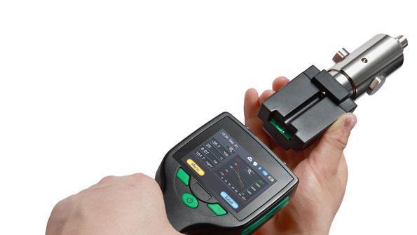

Hygrometers
Hygrometers help determine the atmospheric or pressure dew point of air. It is important to decide whether you need a pressure or atmospheric monitor. The pressure dew-point monitor is typically inserted directly into the system’s air flow, while the atmospheric monitor uses a sample tube and a cell, into which a sensor is inserted. Monitors can handle many different pressure dew-point ranges; –0° to –100°F, –40° to 40°F, 0° to 75°F, and –50° to 80°F are common.
Careful installation of hygrometers is critical, because most sensors contain activated alumina or lithium crystal, which cannot handle liquid slugging or exposure. (A few optical hygrometers can handle infrequent slugs of liquid, though.) Thus, damaging the sensor may be very costly. It does seem odd that something that measures the presence of moisture cannot handle moisture in a liquid state!
The air system should be dried before installing the sensor. This may mean several days of running time, to ensure total removal of liquid. (It should be determined whether the sensor is capable of transient or continuous high-relative-humidity conditions; if so, also determine the length of the recovery time.) Often times, a high dew-point alarm is available, and in many cases, 4- to 20-mA output for trending is an option.
When installing this type of equipment, the goal is to check the air quality going downstream to the users—not the performance of the treatment equipment. If an expander, intermediate control, or other metering device is being used, the test equipment should be installed at the final entry point to the overhead system downstream of this equipment.

Miniaturization of components and microelectronics enable complex instruments, such as this dew-point monitor, to become handheld devices that can be used at multiple locations throughout a plant. (Courtesy of CS-iTech GmbH, cs-itech.com)
