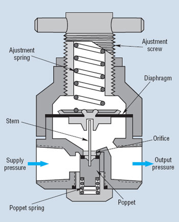

Figure 1. The simplest regulator has an adjustment spring and an unbalanced poppet. It does not have a separate diaphragm chamber, and it is non-relieving.

Unbalanced poppet, non-pilot operated — Figure 1 shows a simple regulator with unbalanced poppet; that is, it is not pilot operated. Normally, supply pressure enters the regulator and flows around the normally closed poppet, blocking flow.

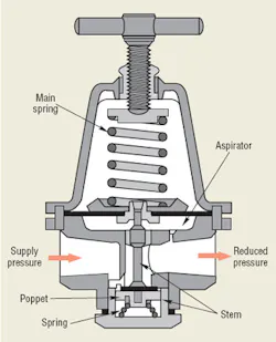

Figure 2. This regulator is similar to the simplest design but has a separate diaphragm chamber containing an aspirator tube connecting to the reduced-pressure port. It is self-relieving.
Turning the adjustment screw to compress the adjustment spring forces the diaphragm down. It pushes the stem down and the poppet uncovers an orifice. As downstream pressure rises, pressurized air acts on the underside of the diaphragm, balancing the force exerted by the adjustment spring. The poppet throttles the orifice to restrict flow and produce the desired pressure. As downstream flow demand varies, the regulator automatically repositions the poppet in relation to the orifice. The spring under the poppet ensures that the regulator will close at no-flow. This regulator is non-relieving.
Unbalanced poppet, non-pilot operated with diaphragm chamber — The regulator in Figure 2 is larger (and more expensive) than the model in Figure 1. It also has a chamber that isolates the diaphragm from the main air flow to help reduce the effects of the abrasive air on the diaphragm, extending life.

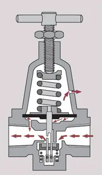

Figure 3. This regulator has a balanced poppet and a separate diaphragm chamber with an aspirator. It is non-pilot operated.
An aspirator tube connects the diaphragm chamber and the outlet chamber. As flow through the regulator increases, the tube creates a slightly lower-than-outlet pressure in the diaphragm chamber. Pressure under the diaphragm deflects it downward, forcing the poppet farther away from the orifice. The adjustment spring extends to open the poppet orifice without significantly decreasing outlet pressure. The effect is the same as increasing the adjustment setting and, thus, reducing output pressure decay (droop) at higher flow rates.
This regulator’s much larger diaphragm area produces greater forces and, thus, displaces the poppet more with a given change in reduced pressure. It also increases regulator response and sensitivity. This style regulator has minimal droop as supply pressure varies. As discharge flow through the regulator is increased over its entire range, output pressure droops. Thus, it is important to set the regulator’s desired output pressure for normal flow conditions.
Balanced poppet, non-pilot operated, with diaphragm chamber — This regulator, Figure 3, has the same general internal construction as the previous type. However, it has a considerably larger orifice to allow for greater flow. In addition, to maintain good stability, the poppet is pressure-balanced; that is, the poppet sees the same reduced pressure on both top and bottom surfaces. Thus, the effects produced by reduced pressure fluctuations cancel out, and sensitivity and response are greatly improved. This very-large-capacity regulator has low droop.
With an exactly balanced poppet, the system-pressure/reduced-pressure ratio has no effect because the unbalanced resultant forces on the poppet caused by supply pressure are zero. However, these poppets are generally designed with a slight tendency to close. Therefore, a large increase in supply pressure forces the poppet closer to the orifice, throttling flow. This causes the reduced pressure to drop slightly.

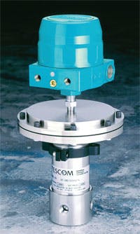

Electropnuematic PID controller with mechanical regulator combined with an accurate pressure transducer produces output pressure equal to within ±0.1% of command signal. Photo courtesy of Tescom Corp.
Electronic pressure control
As the trend toward automation continues, electronic control of pressure is a logical progression. Such electronic control of pressure has, in fact, become commonplace — both to allow automatic control of pressure for production machinery and for controlling pressure from a central location, even if the regulator is placed in an inaccessible or hard-to-reach location.
Instead of requiring operators to set pressure manually, a regulator may contain an electric motor that turns an adjusting stem until the desired outlet pressure is reached. Another design — sometimes referred to as an I/P or E/P transducer — accepts an electronic input signal (either E for voltage input, I for current) and produces an output pressure that is proportional to that signal. If the command signal (typically 0-5 or 0-10 V DC or 4-20 mA) calls for greater pressure, a valve in the regulator shifts to expose the outlet connection to the higher incoming pressure. If lower pressure is called for, a valve shifts to open and bleed the outlet to atmosphere.
With both the I/P and E/P designs, the device controls regulator pilot pressure, comparing this pressure to the command signal and acting accordingly to either decrease or increase outlet pressure, which in turn, increases or decreases the regulator outlet pressure. However, outlet pressure is affected by changes in flow, temperature, and other process disturbances, so to sense these changes and adjust the pilot pressure accordingly, the loop is often closed in a PLC or other control.
A third type of electronic controller closes the loop with an onboard microprocessor that accepts a signal from a pressure transducer located on the outlet of the regulator, compares that signal to the command, and automatically adjusts the pilot pressure to obtain the desired outlet pressure to compensate for any process disturbance.
If needed, the regulator can also supply an electronic signal representative of the process pressure for monitoring, data acquisition, etc. Versions that interface with digital controls are also available.
