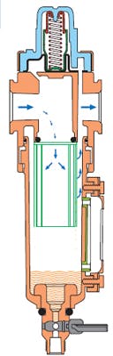

Most standard air-line filters remove water by centrifugal action but, due to their small particle size, aerosols are unaffected by this action and require special coalescing filters. These filter elements have an extremely fine mesh that intercepts and captures the tiny aerosol particles using three different mechanisms: direct interception, inertial impaction, and diffusion. In direct interception, oil particles simply collide with and are trapped by filter fibers. With inertial impaction, a turbulent air stream throws oil particles against fibers, which trap the oil. And diffusion causes the smallest particles to vibrate and collide with each other — and eventually the element’s fibers — which traps the oil.
These filters also remove minute water droplets, but they must be protected against gross dirt or water contamination by means of standard air filters mounted immediately upstream. These prefilters should remove particles of 5 μm or smaller. Otherwise, the coalescing filter may quickly become choked and blocked with dirt, requiring premature filterelement replacement.

Coalescing filter elements have an extremely fine mesh that intercepts and captures tiny aerosol particles.
