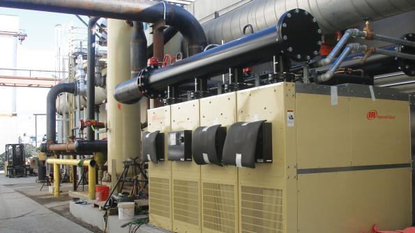

Heat-of-compression units are the most energy-efficient dryers. They use heat generated by the compressor and desiccant towers to dry the air, delivering dew points of about -40°F.
