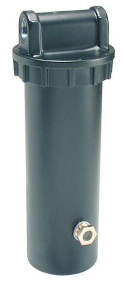

Inline desiccant dryers produce dew points to -40°F.

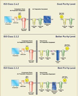

Specifying air purity Fortunately, a range of drying options can help eliminate these costs. Some applications need only a single component to reach the requisite purity. Most, however, require a multi-step circuit that includes several progressively aggressive purifying methods. Among the options available:
• Aftercoolers reduce the temperature and water content of compressed air.
• Bulk liquid separators remove liquid condensed in the distribution system.
• Particulate filters remove solid-particle contaminants down to 5 μm and separate bulk liquids from the air stream.
• Coalescing filters remove liquid aerosols and particles (not vapors) down to 0.01 μm in size.
• Refrigeration dryers generate dew points of 37° to 50°F.
• Desiccant dryers produce dew points of -40° to -100°F.
• Membrane dryers have variable drying capabilities from -40° to +35°F dew points, depending on flow. In most plants, one compressed air system supplies many applications. But actual point-of-use air quality requirements vary depending on the individual workstation or machine. As a rule of thumb, compressed air should be treated prior to entering the distribution system and at each point-of-use. This approach provides the most economical system purification by removing residual contamination in the distribution system while ensuring that critical areas receive air treated to the highest purity – to protect valuable equipment and prevent expensive downtime.
Experts recommend a careful approach to system design, commissioning, and operation to meet the stringent air-quality levels required for today’s modern production facilities. The International Standards Organization (ISO) sets the standard for the quality of compressed air, detailed in ISO 8573. Point-of-use filtration and air dryers help companies meet these goals.

– Adsorption dryers are for applications that require extremely dry air. They are generally installed downstream of an aftercooler and/or a refrigeration dryer. Inline adsorption dryers rely on desiccant contained in a vessel. Compressed air passes through the vessel and across the desiccant bed, which adsorbs water vapor. Very dry air exits. Dew points vary according to the application, but typical levels are -40°F and dryers with special options can reach -100°F.
Heatless regenerative desiccant dryers also use the dry air to remove water from the desiccant material. Air is redirected to one of two desiccant beds at regular intervals, regenerating the inactive bed. Dry air passes over the inactive desiccant bed and water evaporates. This moisture laden air subsequently vents to atmosphere. The major advantage to heatless desiccant dryers is reduced dependence on expensive utilities, particularly steam, electricity, or other heat sources. The dryers require relatively little electricity to operate.
Depending on the size, users can install adsorption dryers near the point-of-use to deliver instrument-quality air for critical applications. It is important to note that the actual temperature of air exiting an adsorption dryer is not the same as its dew point. This is beneficial since a pressure dew point of -15°F or lower not only prevents corrosion, but also inhibits the growth of microorganisms within the compressed air system.
Protect desiccant dryers from liquid water by installing a coalescing filter upstream. Oil or water entering the dryer adversely affects dryer performance and can destroy the desiccant material. It is also good practice to install a filter downstream from the dryer to prevent desiccant from carrying to downstream equipment or processes.

Complete dry-air systems Install point-of-use dryers based on cost, fit, and function. But the time and expense saved in maintenance, reliable system performance, and higher air quality are all reasons to consider installing a dryer, regardless of the product manufactured or aircompression system. When creating a complete, clean and dry air system, keep the following in mind:
1. Dryness is relative. For general plant air, the compressed air’s dew point should be about 20°F lower than the lowest ambient temperature to avoid freezing. 2. Inlet temperature is a key factor. A 20°F temperature drop condenses 50% of the humidity out of the air. 3. Do not overspecify. Drying the entire compressed air supply in a factory to -40°F dew points is wasteful. It is more sensible to subdivide the compressed air supply by application, treating each end-use point as needed to provide appropriately dry air.
4. Do not underspecify. Damage caused by wet air costs money in maintenance time and supplies, downtime, and lost product. Design a drying system to meet specific needs. 5. Avoid potential problems. A drying system that only contains an aftercooler and a coalescing filter could create problems with condensation downstream from the aftercooler. The air is still saturated with water vapor which will likely condense if ambient temperature is lower than the compressed air temperature. 6. Refrigeration dryers are ideal for general purpose applications. But keep in mind this type of dryer does not generate dew points below freezing. 7. Desiccant dryers are suited for applications requiring extremely dry air. Two main types of desiccant dryers are heated and heatless. In general, applications below 1000 scfm work best with heatless, while heated dryers best serve applications above 1000 scfm. 8. Membrane dryers handle applications requiring dew points to -40°F. They require no electricity and, with proper pre- and post filtration, the dryers are maintenance-free.
