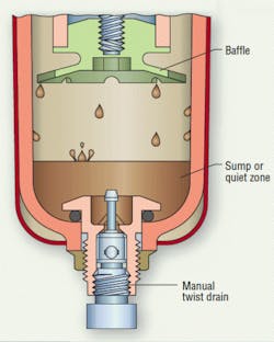

Figure 1. Cutaway view of air filter. Air entering the top of the uint first flows through an element to remove solid particles. It then flows in a circular motion, where centtrifugal force separates water from the air stream, and the water falls to the filter’s sump.

Airline filters come in two main types or styles: standard and coalescing. A standard airline filter, Figure 1, is responsible for two things in a pneumatic system: to remove particulate contamination from the air line and to eliminate water. Water is removed via a centrifugal swirling action inside the unit. This centrifugal action throws the water to the outside of the filter bowl, where it runs down into the filter's sump area, located under the filter's baffle, where it is collected. A common example of this type of action is a home washing machine during the spin cycle. Water is extracted from clothes by spinning them rapidly; centrifugal force flings water droplets through holes along the drum's wall.
The most common mistake made in selecting standard filters is oversizing them. A typical system has pipe or tubing sized for the port size of the actuator to be used. Therefore, the pipe size for the air preparation unit has been predetermined. This method of pipe size is right size specifies filters that are too large for the application, creating flows too low to effectively remove water from the system.

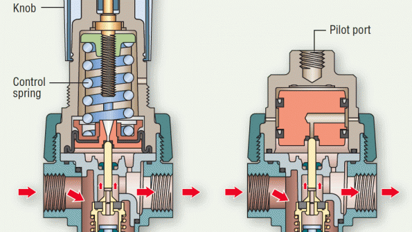

Figure 3. Regulators are offered in manual-operated, left, or pilot-operated styles, right.

The next choice is to select an adjustment style: manual-or pilot-operated, as shown in Figure 3. Manualoperated units use a control knob or T-handle to adjust the regulator's output pressure. The non-rising control knob is the most common style used in today's market, because of its compact size and styling. The T-handle version is the more traditional style and is more commonly found on heavy duty applications.
A pilot-operated regulator simply replaces the standard control knob and spring with a pilot chamber. A small external regulator supplies a control pressure to the pilot chamber. Since most pilot operated regulators have a 1:1 ratio of pilot pressure to output pressure, a pilot pressure of 100 psi would deliver 100 psi out of the main regulator.
