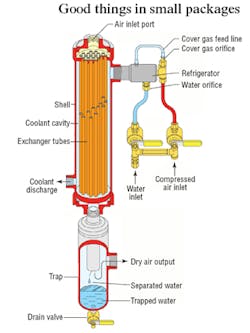

Figure 3 shows a schematic representation of how the Elliott cycle refrigerators can be configured with a heat exchanger and trap to form a compressed air dryer. Unprocessed compressed air is introduced into the air input, where it flows through the heat exchanger tubes, shown as a single S-shaped tube.
Figure 3. A key component of the Elliot refrigeration dryer is a shell-and-tube heat exchanger, which uses cooled water vapor to condense moisture out of the compressed air stream.
The refrigerator produces a cooled vapor cloud that is saturated with normalized micro-droplets and discharged into the coolant cavity of the heat exchanger. The vapor cloud is forced to flow through the heat exchanger — where it cools the outside of the exchanger tubes — and out the coolant discharge port.
When the unprocessed air comes in contact with the inside of the cooled exchanger tubes, its temperature drops. As the air temperature drops, its affinity for water vapor also drops. As the water is shed from the compressed air, it condenses onto the inside of the exchanger tubes. The condensed water runs down the inside of the tubes along with the compressed air flow and is discharged through the heat exchanger output.
The air and liquid water are routed through a separation trap, which forces the dry air into a series of turns designed to separate the liquid water from the air stream. The separated water collects into a small reservoir and is periodically drained through the trap’s drain valve. The now dry compressed air flows through the output of the trap and is introduced to the distribution system.

Figure 4. This version of an Elliott cycle dryer is designed for small, packaged compressors. Because only water and compressed air may be used to provide refrigeration, spent coolant can be discharged directly to the atmosphere.
A sectional view of an Elliott cycle dryer designed for small, packaged compressors is shown in Figure 4. The body of the heat exchanger is constructed from a piece of Schedule 40 steel pipe with forged steel fittings and mild steel tube plates. The assembly features all-welded construction for longevity and reliability. The internal tubes of the exchanger are made of Type 122 copper and bonded to tube plates using a proprietary process.
The refrigerator mounts into the 12-in. female NPT port at the top of the heat exchanger shell, and the coolant discharge is located at the bottom of the shell. The trap assembly is of the same construction style as the heat exchanger — all-welded Schedule 40 pipe components with forged steel fittings. The input nipple of the trap is specifically matched to the reducing bushing that makes up the heat exchanger output.
