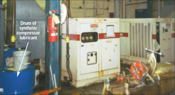

Figure 1. Areas housing compressors often are not maintained at the same high cleanliness standards as those found in the production areas of a food processing plant.
As we look over the air filtration in the engine room, Figure 1, we find that the filters are the same type as those found in many other industries — not those designed for the food and beverage processing industry. In addition, it is not unusual for filters to be three months overdue for service or replacement. Moving out onto the production floor, we hope to find adequate filtration used on the actual process machinery. Unfortunately, examining much of the equipment reveals that the point-of-use filtration often is inadequate. Even more disturbing, the compressed air is making incidental — or even direct — contact with the food products or their containers.
Why do we, as compressed air system auditors, notice a few drums of synthetic compressor lubricant? We see synthetic oil all of the time, but we shouldn’t see it in the food processing industry if there is any contact, either direct, or indirect, with the food or beverage product or the containers for holding that product. However, we frequently encounter synthetic compressor oil in food and beverage processing plants all over the United States. In many cases, we find facilities using compressed air containing unacceptable levels of synthetic lubricant to perform tasks such as aerating ice cream, manufacturing beverage containers, and drying the inside of bottles and jars, prior to filling.

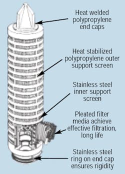

Figure 3. For applications where compressed air may have direct or incidental contact with food, beverages, or their packaging, filters with pleated PTFEelements should be specified to minimize potential product contamination.

Whether a food processing plant uses lubricated or oil free compressors, proper filtration is still required to ensure that clean air is supplied to the process equipment. Specialized filters — such as activated carbon filters or PTFE-impregnated depth or membrane surface filters — are also required as part of the in-line filtration package. PTFE filters use non-shedding, hydrophobic filter elements to eliminate bacterial contamination in the compressed air stream. These filters, Figure 3, must be cleaned with steam to ensure their continued effectiveness. PTFE filters meet FDA requirements of CFR Title 21 if clean, dry compressed air is supplied to them. Therefore, pre-filtration for these filters is essential in meeting FDA requirements, Figure 4.
It is essential that the compressed air be clean prior to reaching the PTFE filters. But clean, dry air is beneficial for most applications, not just food and beverage processing plants. Clean, dry compressed air can maximize the life and reliability of cylinders, valves, and seals, leading to lower maintenance costs and higher productivity through reduced downtime.
