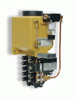

The Automation PAC is a self-contained assembly consisting of an oil reservoir, up to 20 precision oil injectors, and a frequency controller. It’s suitable for valves, cylinders, and other pneumatic components.
Multiple-point injection lubricators can hold up to 10 Servo-Meter injectors, for up to 10 lubrication points. All use the same oil and air sources.
