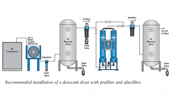

Figure 1. Recommended installation of a desiccant dryer with prefilter and afterfilter. Select image to enlarge.

Aerosol filtration is required upstream of the compressed air dryer, after the dryer, and downstream at each point-of-use in the air distribution system. Liquid and particulate aerosols are removed before the air dryer to prevent adsorbent fouling in desiccant dryers (see Figure 1) and to prevent fouling of the heat exchanger tubes in refrigeration air dryers, Figure 2. Adsorbent fines from the desiccant dryer, as seen in Figure 1, and water mist from the refrigeration air dryer, Figure 2, are removed from the compressed air system by a downstream filter.
