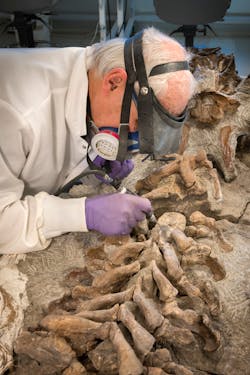

For the next several days, Museum crews excavated bone after bone encased in soft sand and jacketed them in plaster for transport back to the museum. By Friday, visitors to the Museum’s Prehistoric Journey Exhibit could watch volunteers in the paleontology lab meticulously remove the sandstone matrix from the bones of what they would later learn is an extremely rare specimen of horned dinosaur—a Torosaurus.
The dinosaur may be rare, and the setting exotic, but the demands on the lab’s pneumatic tools are as rigorous as any plant that runs, as this lab does, 364 days a year.

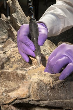

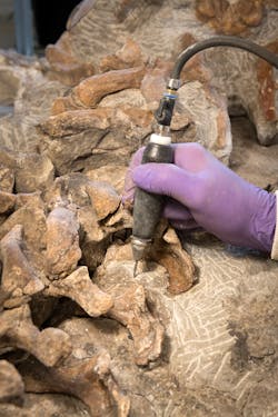

Like a typical factory or shop, the lab uses pneumatic tools for many tasks. Volunteers use pneumatic scribes—tiny jackhammers with carbide tips and strokes measured in millimeters—to carefully chisel the stone matrix away from fossilized bones and teeth. Media blasters blow sodium bicarbonate to remove the matrix from specimens too fragile to scrape. Preparators use air nozzles to remove bubbles from mold-making materials as they create research quality casts of fossils too valuable and delicate to travel.
All of these applications require clean, dry air. But they didn’t always get it. An old compressor that threw off oil, mainline-only filtration, and a legacy piping system of copper and black pipe took their toll on the sensitive tools. In particular, scribes had to be taken out of use, disassembled, cleaned, and rebuilt every couple of months because particles and moisture impaired consistent performance. Preparing a fossil is slow, painstaking work, and tool downtime was making the process even slower.
