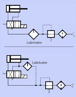

Even though industry has trended toward using non-lubricated air, the benefits of using an air lubricator are undeniable. Whatever the choice, the decision must be a prime consideration.
Airline lubricators have been used in factor pneumatic systems for decades. Lubrication helps reduce friction between sliding surfaces to improve efficiency and increase cycling speed of a component. It also reduces wear, which ultimately means longer component life and less maintenance.
In a pneumatic system, lubrication can reduce both internal and external leakage around valve spools, cylinder rods and pistons, air motor and rotary-actuator vanes, rotors, and housings, among other components. This goes for conventional pneumatic components as well as those that can operate with non-lubricated air. Ultimately, the total savings from using lubricated air can exceed the cost of installing and maintaining the lubricators.
A small amount of oil in compressed air works with elastomeric seals to form a tighter seal than if no lubricant were available. This is because some roughness exists even on polished surfaces. Peaks and valleys appear on any surface if viewed at high-enough magnification. A typical pneumatic cylinder wall, for example, is finished to 20 µin. RMS. Fundamentally, this means the average distance between peaks and valleys of the surface is 20 µin.
One reason for the popularity of the 20-µin. finish is that it provides a good compromise of properties. For cylinders, 20 µin. is smooth enough to prevent excessive wear of piston rings and seals, but is rough enough to allow oil to collect in the microscopic valleys of the surface and provide lubrication between sliding components.
As always, the advantages of using lubricated compressed air can be outweighed by disadvantages. Having to monitor lubrication rates and replenish oil supplies keeps operators from spending time on more productive endeavors. Without careful control of lubrication rate, excess oil can create a messy and unsafe workplace. Also, the cost of oil used by a lubricated system must be factored into the operating cost. This cost may seem negligible, but it can add up over time. It may be offset, though, by longer component life attributed to the lubrication.
Lubricators can be installed in different locations depending on the intent. In the upper image, mounting the lubricator upstream of the valve lubricates the cylinder and valve every time they cycle. In the lower image, the lubricator bypasses the control valve and lubricates the cylinder only while its rod retracts. When the rod extends, exhaust air from the rod end of the cylinder lubricates the directional control valve.
