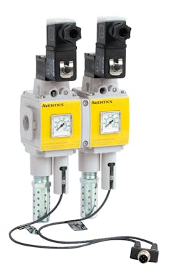

Whether it is a complete lockout/tag-out or implementation of the “minor servicing exception,” the most common method used to render pneumatic components “safe” is to release the pneumatic energy. The preferred component with which to do that is a redundant safety exhaust valve (RSEV). It can be part of an air-preparation subsystem that feeds compressed air to a machine or section of the machine.
Risk assessments indicate that lots of equipment requires a Category 3 PLd safety device (ISO 13849-1) to keep it safe during repairs and servicing tasks. The device must have redundant circuits. RSEVs meet this need by using redundant valves and diagnostics from sensors, such as spool-position monitoring, to ensure stored energy (i.e., compressed air) is released and removed.
When a device such as a safety gate on a machine enclosure is triggered, two safety outputs are sent to the RSEV. If one valve fails, the redundant valve will still complete the safety function. Diagnostics coverage will raise an alarm so that action can be taken to address the failure before operations resume.
Some redundant safety valves feature built-in soft starts. Upon start-up, this feature ensures pressure remains at  60% to 70% of final system pressure before opening fully. The slow buildup of pressure/force, as actuators move to their home/start position, prevents damage to components and equipment.
