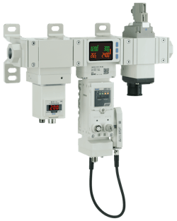

The primary areas to decrease energy and associated costs are air leak reduction and lessening internal leakage of system components such as cylinders and valves. The idea is to reduce pressure or completely shut off the air supply during machine idle times. Manufacturers install flow, pressure and temperature sensors, pressure regulators and shut-off valves at the machine point of use to measure and ultimately control airflow and pressure to a machinesaving costs (Figure 1).
With the digitized data collected, these sensors detect user-defined idle times during a machine cycle and automatically reduce the pressure controlled by an electropneumatic air regulator. During long-term idle times, a two-way valve is used to completely isolate airflow to a machine.
As machines are idle at maximum pressure during non-production or minor stoppages, the inherent amount of leakage due to line or connector loss or internal component leakage can be high. Parameters can be set in the point-of-use air managment system to detect idle time and programmed to reduce air pressure for a period of time called standby mode. Reducing the air pressure decreases the potential for leakage and wasted air during these idle times, therefore reducing the CO2 emissions related to lessened compressor load.
The unit enters isolation mode during prolonged inactivity, triggering the two-way valve and ultimately stopping airflow altogether. These long-term idle times can be programmed for weekends and seasonal, planned, or unplanned downtime. These periods can also be relatively short, like when a machine stops for only a few minutes.
Note that during standby mode, pressure is reduced but not completely shut off. Therefore, air will remain in the system. When returning from standby mode into normal operation, ramping back up to pressure takes less time than it would in complete isolation mode, with the air pressure entirely exhausted from the system.
