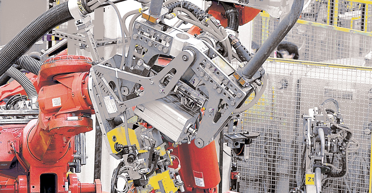

One of the shortcomings of traditional electropneumatic systems is the inability to control both position and force. For example, maintaining welding tip force in automotive body welding applications at an accurate position is very difficult to achieve. However, by using a closed-loop feedback system, advanced electropneumatic positioning systems can apply the additional pressure required at a given position to maintain the force needed to achieve an accurate weld.

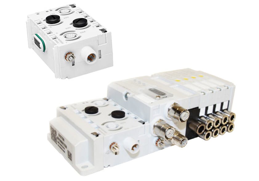

Aventics, for example, has a multiple closed-control loop positioning system available as a module that is compatible with current AV valve systems. The modularized design easily integrates into valve manifold assemblies to turn valves on and off using different communication protocols.
An advanced electronic pneumatic positioning system (AES) integrated with PID technology eliminates dithering associated with flow-based pneumatic positioners. And adding multiple closed-loop control enables dynamic force control for reliability and safety in securing load position.
