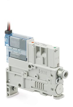

Jensen said vacuum venturis can be an energy-efficient component option to consider for some applications as well. These devices use compressed air to generate a vacuum. “The traditional method is to supply air continuously while you are requiring the vacuum to be generated to pick up a workpiece, for example,” he said.
He noted newer technologies use multi-stage venturis which are more efficient than the legacy single-stage types. They are also equipped with automatic shutoff, enabling the compressed air supply to be turned off when the level of vacuum is sufficient to hold a part in place or lift a workpiece. “It applies vacuum only when required and gives you considerable savings.”
