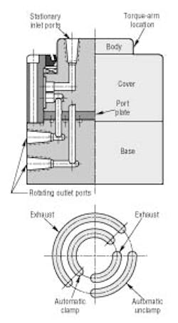

If, instead, a single rotary timing valve is installed, it can handle supply-air flow as well as control functions. This valve combines 360° rotation with a custom slotted element to provide automatic on/off control of pressure-fluid flow to individual clamping fixtures. (Should external control be required, it can be included within the valve.)
For example, if the load position must have a part clamped in the fixture prior to rotation, a single control can be used rather than the multiple controls required with a rotating-union arrangement. The predetermined sequence is machined into the rotary timing valve.

Valve configurations may be cylindrical or disk type. Selection depends on the characteristics of the particular fluid, operating pressure, speed, and the physical requirements of the user's equipment. For attachment to an index table or other rotary machine element, the rotary timing valve can be built with a flange. Or it can be designed to mount on a through shaft or shaft end. Full 360º grooves can be included for continuous flow of other fluids, such as coolants, and for venting or barriers.
