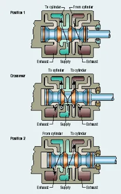

Fig. 1. Cutaway of packed spool valve shows flow being partially exhausted when valve shifts positions.

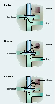

Fig. 2. Cutaway of poppet valve shows how flow can briefly be exhausted when valve shifts positions.

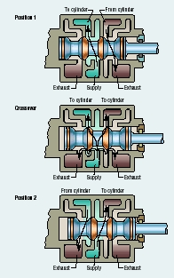

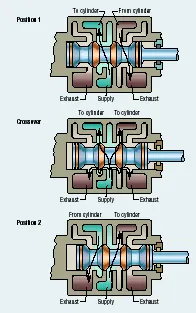

Fig. 3. Cutaway of spool and sleeve type valve shows flow paths in various positions.

The critical assessment of a valve's efficiency is not when it is stationary, but when it shifts, because the function of a valve is to shift. A dynamic seal valve, whether a poppet or spoppet, will often suffer from a condition known as open crossover when a valve shifts.
Open crossover during rubber packed valve shifting can cost hundreds of times more waste than the thin film of air required to support an air bearing in a lapped spool-andsleeve valve. As seen in Figures 1 and 2, both the poppet and packed spool type construction suffer leakage every time the valve shifts, because the dynamic seal is not wide enough to seal across the gallery opening as the flow path changes from the A to the B position.
The loss of air during this period of open crossover is substantially greater than the consumption of a quality spool and sleeve. Further, the spool-and-sleeve style construction is designed to have a land that is wider than the gallery opening. Thus, there is no increase of air loss while the valve is shifting, making the spool and sleeve design one of the most efficient air valve designs with regard to minimal air leakage.
