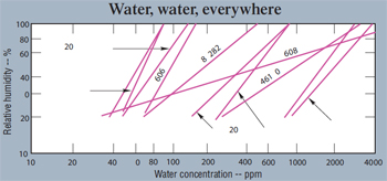

Graph shows water solubility in a variety of carbon-based hydraulic fluids.

Each fluid has its own saturation level for water. Below the saturation level, water can be completely dissolved in the other fluid. For oil-base hydraulic fluids, the saturation level is likely to be in the range of 100 to 1000 parts per million (0.01% to 0.1%) at room temperature. The saturation level is greater at higher temperatures.
