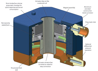

Magnetically coupled valve actuators use pneumatic force to shift a tubular-shaped permanent magnet which, in turn, drives the valve armature. An inexpensive air pilot using a small-diameter, flexible pneumatic line shifts the valve – much the same as with traditional pneumatic-actuated valves. No electricity, field wiring, conduit, or intrinsically safe barriers are required.

Process fluid seals are a prime source of environmental contamination and present a secondary safety hazard. Magnetically coupled valve actuators eliminate this problem. These self-contained pneumatic-magnetic devices use pneumatic force to shift a tubular-shaped permanent magnet which, in turn, drives the valve armature with the same magnetic force as a solenoid coil normally provides.
Because a magnetic, not mechanical, connection shifts the valve, there is no need for a packing or fluid seal. This eliminates leakage issues inherent in other valves.
The PneuMagnetic actuator from PneuMagnetic LLC, for example, is a drop-in replacement for the OEM coil on direct-acting solenoid valves and requires no valve modifications. It provides the same powerful on/off magnetic field as solenoid coils with the same control of flow.
In fact, dc solenoid valves typically cannot handle pressures as high as their ac versions. Advances in rare-earth magnets let Pneu-
Magnetic actuators provide the same valve pressure performance as equivalent ac versions. Rated life is at least 7 million cycles.
Because PneuMagnetic actuators fit directly on solenoid-valve bodies, this makes a wider range of valves available to the system designer. For instance, actuators currently available fit several major brands of solenoid valves.
